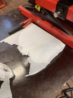

Fingers crossed she seems to bee tight.
Warm-up 10 minutes an still no oildripp
