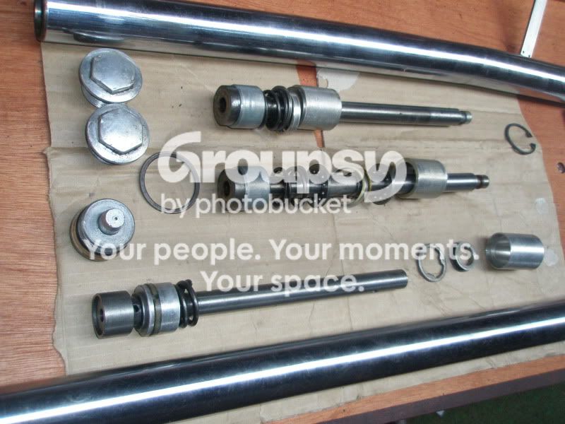

I pulled the old Cerianis apart as well as the old marzos I have. It seems the Cerianis valve set-up is gar superior to the Marzos. It's been quite some time since pulling the dampening apart on my Marzos fitted to the 1200 so can't remember whats in it but if my spare set is anything to go by, the Marzos are lacking in parts. The forks have been sitting around for 25 years and can't remember where they came from so maybe some parts are missing. I'll need to pull the 1200 marzos apart to compare.
I'm still keen on using the Ceranis but would like to know if the Racetech springs/goldvalves are transferable to the Cerianis, if so I'll go down that route.
The photo shows the difference between the two dampening set-ups.

The Marzos are certainly simpler down at the business end compared to the Cerianis. I kind of think that there might be some parts missing out of the old marzos though.

Rob, there is nothing wrong with you picture of the Marz internals - it is all there. Simple, simple, simple.

Paul, well compaired to the Cerianis they're real simple then if all the parts are complete.
