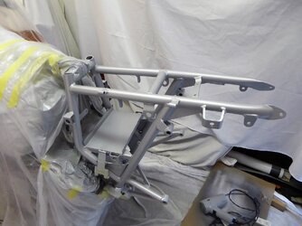

I'm getting around to the restoration of my 1978 Jota (silver..) again. All stripped and engine being refurbed and hopefully nice and shiny.
My question is about frame/ headstock bracing. Whilst it's in bits and going to be powder coated, should I have some bracing welded in? There is no damage and it isn't going to be "abused" (raced/ rallied) in the future... But, I don't want to not do it and have issues when (eventually) it's back on the road. I've looked at examples of bracing on this forum and they all seem different, with some appearing to lose the coil mount bracket.

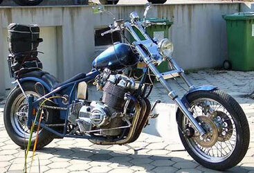

Increasing the length of the head tube as grant has done has genuine advantages in shortening the length of unsupported fork leg (reducing flex) but is a more involved job.

Thanks Schumy, interesting reading and very useful. I think that if I can find someone locally I'll go with the "Redax" solution - I'll sleep on it, put away Autocad and get the cardboard cad out. Two pack epoxy or powder coat again depends on suppliers. I have a very good powder coater locally..

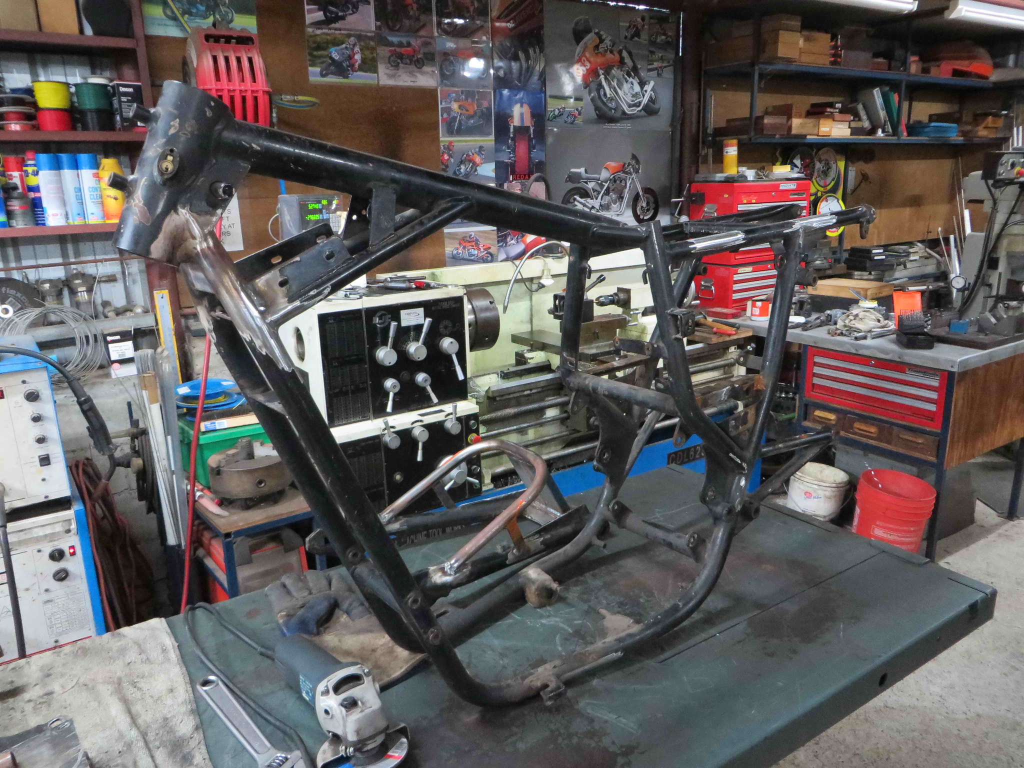

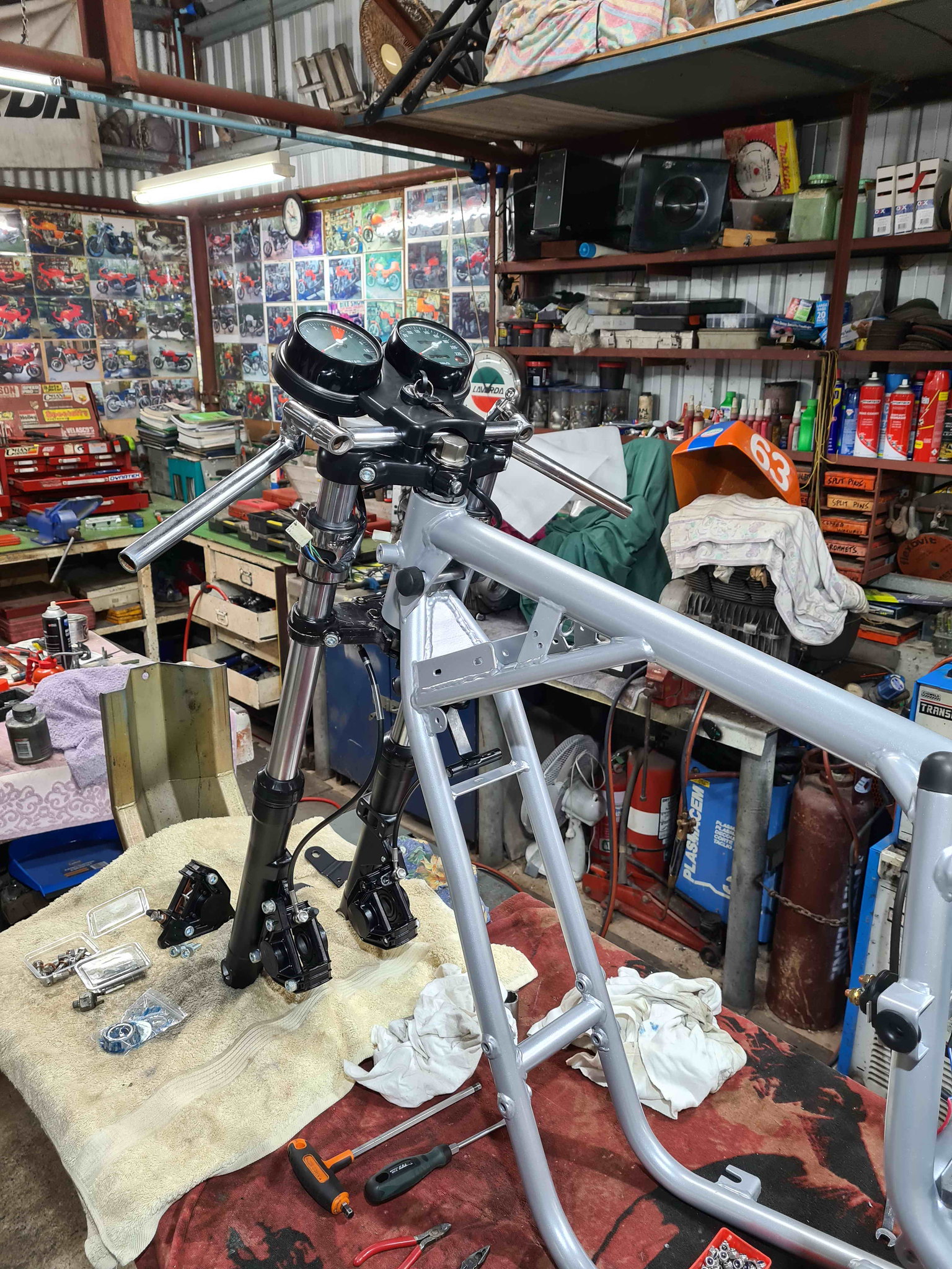

this is what we do on 180 frames, first job when restoring a bike
send rolling chassis to our local frame expert who straightens the frame and welds in a headstock brace to stop the downtubes from cracking
he says every frame is bent, just depends on how bad
8th Mar TC frame 1
easier to see the added brace in this photo
TC headstock brace
Thanks redax5, I think that's the path I'll be following. Do the horizontal welded flat bars add to the solution or are they for something else? You're reputation speaks for itself, you just need to be nearer!
