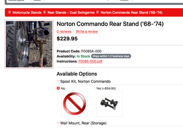

Good point Gert- Pit Bulls are usually designed for wider 17" wheels, but this Norton lift would work except that the Laverda mufflers would have to be temporarily removed to use the shock mounted bobbins. I contacted Pit Bull to see if they offer something else
I'm waiting to hear back from Pit Bull if they can fabricate a rear lift for me. This Norton lift would work except the shock mounted bobbins would be in the way of the Laverda mufflers- it would work w/ an SFC single exhaust
