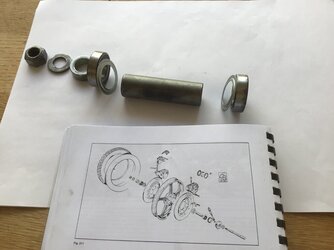

Now I’m ready to rebuild but can't for the life of me remember which way the two thin large dished washers/spacers go.
The manual appears to show they go in first so they're on the inner side of the bearings, but which way round does the dish go ?
Again from the manual it appears the dish protrudes inwards toward the centre of the hub.
I guess the dish provides location of the spacer tube to rest on to centralise it all.
Is this correct ??
I don't want to re assemble to find they're the wrong way around ☹️
Correct. Your photo shows how the spacers are oriented.
