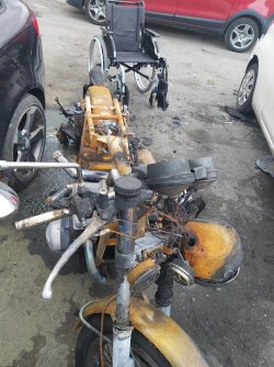

Fuel cap issue?
Not surprised you knocked it over. Must be tricky getting out of the wheelchair and onto the bike.
