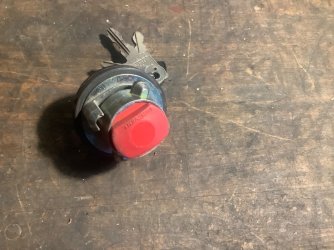

Hello, I have a question about the fuel cap on my RGS.
Now that I’ve got the RGS roadworthy again and I want to fit the fuel tank, a lot of petrol is leaking past the fuel cap when I try to refit it. I’m also expecting petrol to spray out of the cap during hard braking.
I think the small rubber ring just below the black plastic where the lock is has dried out.
Does anyone know a solution to make the fuel cap leak-proof again?

I still have a spare tank that had a fuel cap on it but no key... I drilled the lock out today and managed to remove it. So it’s exactly the same as the one in your photo. This rubber has also gone hard. I’ve now soaked the rubber in engine oil to soften it up a bit. I got this tip from an old Laverda dealer.☺️
I’ve sorted it out for now with a extra spare O-ring. It’s sealed for the moment... I’ve ordered a couple of spare Viton O-rings in size 44x2 and 3 mm thick. Let’s see if that works as well.
By the way, does anyone know where or which cylinder lock fits into the cap, as shown in Andre's photo?
I’ve drilled out the cylinder and am looking for a suitable cylinder lock for this.
