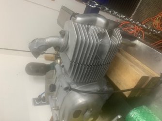

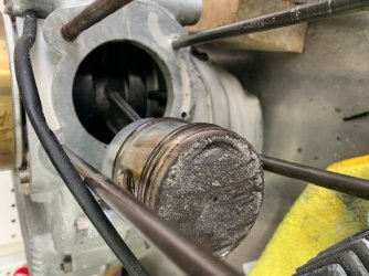

Wolfgang tells me I am out of luck for engine gaskets, will have to make my own. Not the end of the world, I will get some gasket sheet. The head gasket did not tear when I took the head off, should be able to re-use it with some sort of gasket sealer.....
Better news is Wolfgang says he thinks he has some Deves rings he had made a long time ago for the 150's, and may also have an oversize piston with rings, and is going to check out his old stock for me and let me know.

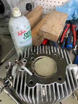

On removing the head and barrel it is obvious that water has gotten in over the years, the cylinder wall is "water spotted" for lack of a better description. Will have to decide if a light hone and new rings on a stock piston will do the job or whether an oversize piston will be required.
When I laid the head upside down and put some oil in the valve chamber with valves closed and spark plug in place, the liquid ran right through the valve seats quite quickly. Wolfgang tells me he is not aware of where to source new valves, so I will try to recondition with valve grinding paste by hand and see how I make out.
A couple of photos of start of dis-assembly.
