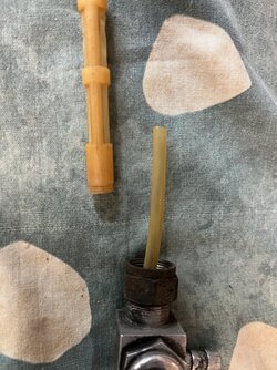

Started leaking. I got the sealant for the inside & a guy told me JB Weld outside. Did this about 30 yrs ago. Put on new knee guards then. Can't get them now. Have to be careful. Now the filters are stuck. Can't pull them out. Got the tank frying in the sun hoping it will loosen them. Any other suggestions???
The filters unscrew from the fuel taps. Push them in and shake them out of the filler hole. Clean out the fuel tap holes with some sandpaper, reattach them to the taps and refitting them shouldn't be a problem.IMG_4631.JPG

Filters may be held by muck in the bottom of the tank.
Unscrew the taps and prise the filters out, there should be some give in them. If not, sacrifice the filters and source some others from dud taps.
Yep, the diameter of the filter 'top' can be a very close fit to the hole in the tank boss.
Suggest unscrew the filters from the taps. Poke the filters into the tank and then get them out through the fuel cap hole. Then lightly sand down the ends of the filters to a smaller diameter, as well as making sure the hole in the tank boss is clean.

Excellent Haggis and Hamish. Yes, push them in.
Ok I pulled them out from the bottom. But one did crack @ the mesh but is still whole. I will sand top diameters of the filters before fitting. & make sure no sealant is in the top of the ports. Thanks...
