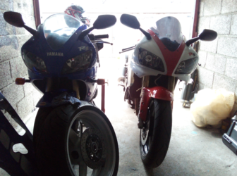

A bikelift would be nice but there`s the expense , and as with Vince my garage is so small there wouldn`t me room for it and me in there at the same time...............see below...( Sorry about lack of Laverda , this pic is for illustration purposes only......).....
