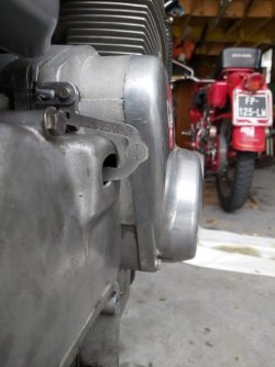

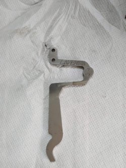

I ground down the DAM lever into near oblivion. Still no good.

I have done some optical calculations usuing every training course and letter after my name plus experience, and that DAM lever is going to distort to the point of inop. My cable cover is coming back Wednesday night and will get pictured on Thursday.

The DAM arm in the photo, is after grinding.
I personally don't like the look of the DAM lever. Much prefer to slot the cover and use a straight lever.

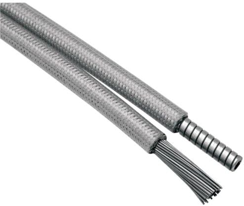

Years ago I installed a Longitudinally-Wound Clutch Cable from Motion-Pro on my 3c. Had it custom made and it still works very well. A much reduced clutch pull effort and minimal adjustments needed.
Long story short..I was off the bike for 18 months in chemo. Started riding again and was very weak.
Clutch pull effort was not a problem (lots of other strength related problems) even with those atrophied muscles in my hands. See if you can source a longitudinally-wound clutch cable.
Will look into those longitudinally wound cables, many thanks.
DAM lever isn't pretty and interferes a bit with my right ankle but if it can keep me riding well into my 70s, fine. I'd rather that than have pretty bikes in the garage.
