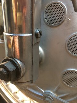

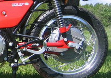

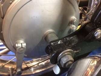

hi to all, I am in the process of starting a new project and in need of some brake hubs, the front is a Grimeca 225mm (9 inch) tls left hand side. very similar if not the same as a 750 super sport early 70s,it has the 3 holes with mesh on the brake plate. the rear hub is an 8 inch Grimeca (I believe) and is the same as the one used on a Ducati 750 GT SS sport round case (2393br) not sure if this is the casting number, I do have a rear hub that I could use but would need both sides, ie brake plate and Cush drive with plate, or complete. I have pictures of what I need but have not worked out how to load them yet. thanks Neil

Front is an S type Grimeca 230mm, not inches. Gt had another. Not the same as the Ducati I think particularly as the 750 SS had discs.
Rear is 200mm, not inches. Same as the big Ducatis I believe but not the same lever.
I have a spare front I think but of the GT type.

750 GT, S and SS Ducati did have the 200mm rear. Only the GT prototype for publicity purposes had a front drum.
I've had a look, but I don't have a spare Grimeca hub.
If it's just a Grimeca 2LS you want, they are pretty common and were obtainable new only a few years back.
The rear pictured looks like the one used on the Ducati GT models, common to the 750 and 860. Shouldn't be too difficult to find complete w/cush drive etc.
thanks to you both, I will keep looking, e bay is obvious, do you know anywhere else to look. I need right place right time I guess. the rear brake plate is on American e bay, but postage and duties make it expensive, so was trying closer to home first
If you want exactly that Grimeca, it's going to be difficult. Only found on the 750 S as far as I know and they were only made for a year or so.
