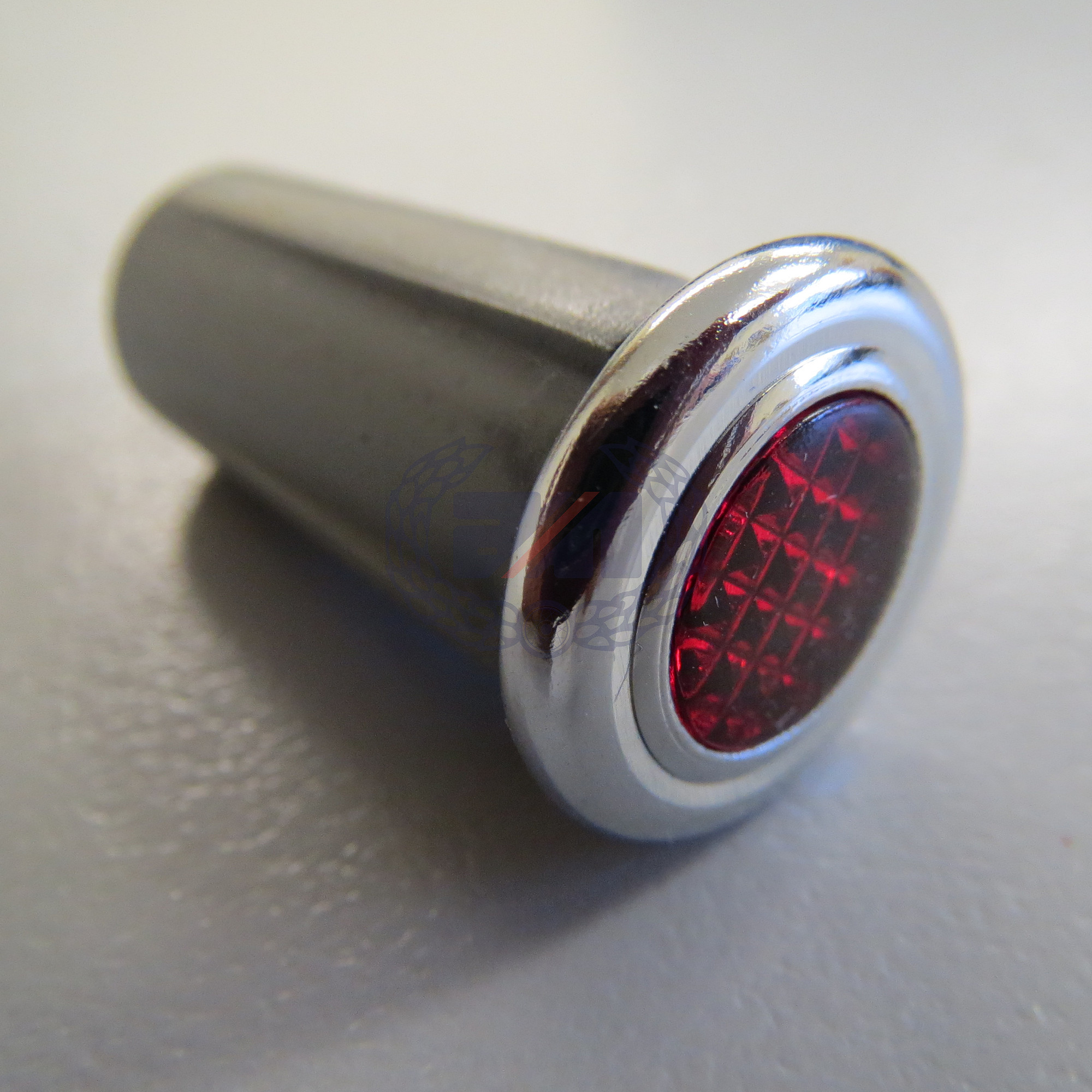

These are the original Lucas warning lights as fitted to Triumph and Norton, they would look more period correct, almost flush fit. The original Lucas on off light switches for are also available from Andover Norton and plenty others too. Search 750 Commando
