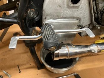

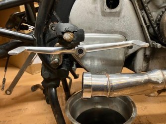

Hi all- due to an old injury, I find it necessary to fit a heel toe to my SF1. I have acquired a factory alloy one similiar to what one Piet has posted a pic of in the past. Unfortunately, the only way it can interface with the existing footpeg is with the peg rocked up to the next index tooth which puts it way to high. I'm wondering if anyone knows whether different footpegs were required or if I could get more pics of one fitted to see where the peg is located relative to the shifter. Unfortunately I don't have have much in fabrication equipment to play with. Any ideas welcome. I have a feeling what I'll probably need to do is find an ugly used one to cut and weld.lav fr2.jpglav fr1.jpg
That's a lever for the early 60's 125 models.
The 750 lever seems to be made from the 125 item and a short vertical bit with splines, welded mid-lever so the rear half of the lever can pass over the footrest. Don't have access to my photos at the moment, try to dig out the pics I posted in another thread (can't remember which).
