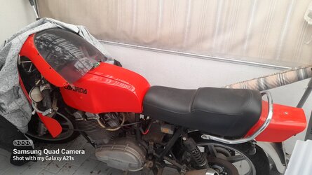

This is my laverda 1200 what you see on the bike is all original

Well... paint, fairing, indicators, rear shocks, mirror, seat cover and exhaust certainly aren't as they left the Breganze gates. Apart from that, a 1200 Lav is a nice bike to have, congratulations!

your bike did not have a fairing when it was new, nor a 3 into 1 exhaust, and the colour is not stock
as paul says the fairing doe look like one from an SFC750 endurance race bike, but there are many copiers of that back in the day. Thankfully your bike is well before the dodgy centre main bearings which started at 1519.

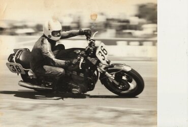

This is what a 12300 looked like from the factory in 1978 - me racing one for the WA Laverda distributor, Hartley Motorcycles, in the Perth Castrol 4 Hour production race. Might even be the one you now won! It was red. I have no idea what number that one was. Nice all-rounder, not quite the ponies to compete against the Yamaha XS1100s and their ilk of that era, but it wasn't entered to win.

Thank you for your reply the bikes exhaust system is 3 in to 1 in to 2 (25643 Km only from new) i am going to restore the bike if you go italy when i was living there in the 70s you could buy parts from the factory for 750 1000 and 1200
Fairing may be original as it looks like an SFC 750 fairing but it was never fitted to a 1200 by the factory
And there are many other parts on your bike non standard as Piet has pointed out, your bike is far from factory original
You are right i do have all the parts of the bike in a box for the paint it is the right its the light coming for the lazer light roof
