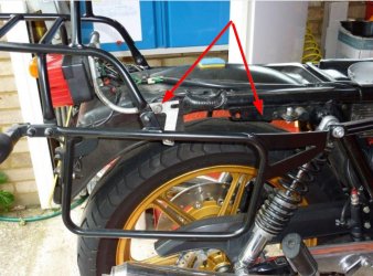

Rgs rack does!! mount to the top shock mount  ;)
Then sub/brace bracket too rear of seat frame. So only two mounting points! These racks and panniers only rated at 10kg each.
Not the best photos, but you get the idea. Non-existent triangulation of pannier brackets. Relies on pure clamping force which is in short supply from a plastic rear mudguard!
I believe original version mounted to inside of rear shock - this was from a batch of 10 produced to special order 2015/6.
I have run my own RGS with a similar setup. The shock bolt was tightened well beyond normal torque. Nothing moved, but ...  :-\

Rob, I'da bin awfully tempted to tack on another bracket to the footpeg bracket. Would have to be pretty curved to fit around the shock but even so...
You could make that problem a lot easier by replacing the shocks with thin rigid struts. And they'd never wear out, either  :D
Ken
That's what I did with my rack, it's very much stronger with that added. All it takes is a length of flat bar, 25x3 to turn them into a truss-like shape. Keeps my cheap arsed soft bags off anything that will damage them as well. It's bloody annoying looking for a weld repair on trips if you get any flexing and bouncing with them loaded.
NO, I added a long thin steel member that goes from the exhaust pillion bolt to as far back on the rack as I could curving outside and past the shocks and fixed at Multiple points. It changed the unbraced shape into a bunch of triangles bracing the hell out of it. Years ago the fibreglass panniers
I used on the 6-week trip I did through outback NSW and Queensland constantly needed weld repairs, the bags bounced up and down like wedgetail eagle wings resulting in the framework hardening and snapping. Not fun and not repeated since.  The so-called road from Goondawindy to Roma has these things called Paddy Melon holes, one mitre deep and 6 mitres long and there are hundreds of them, hit them at speed and they nearly wind you with the bang.
