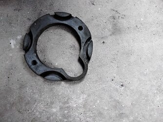

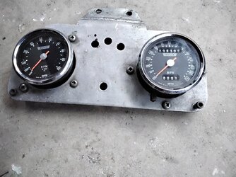

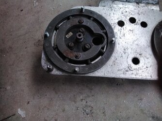

Interesting way of reducing instrument vibration,at least I'll be able to watch the smiths needles flickering now. Threads 5mm dia rubber between instrument and housing. Instruments RSM 3003/11a and SSM 5001/14 for the rivet counters, not sure wuich model they are from.

Original O ring is 104,14 x 5,33
