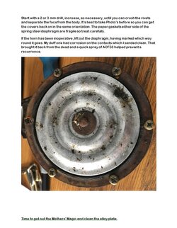

As usual one of my Voxbell horns has stopped working. This happens approx once every year, less lately as I don't wash the bike much these days. It was converted to be held together years ago with nuts and bolts from the std rivets and usually, I pull it apart and sand the rust off the points and adjust the Philips head screw and I get another year out of it. This time I am going a bit deeper. I am going to give the internals a soak in CRC Rust Remover Gel and hopefully slow this rust growth down. But I don't know if after that it will need some Electrical Contact Cleaner to get it honking again. I mount it with the drain holes vertically and after seeing how much rust there is where the wiring connects that's going up top as well so water doesn't seep in there. Any tips for getting more long-term fixes would be helpful. It's a shame the internals are not made in better non-rustable materials.

I now have 2 working horns again. I lucked out with the Philps head horn adjuster screw, it usually takes a while to find the correct tension, did it first go. The rust dissolver was interesting, I couldn't clean it off. I tried electrical contact cleaner, either, kero, degreaser and none worked and then I tried WATER, its water-based and buggar me it washes off with water. Hit it again with contact cleaner and let it dry in the sun for an hour and all good. I will try that rust dissolver on my chain adjusters and rear drum brake link rods and toque arm and get rid of the rust on them as well.

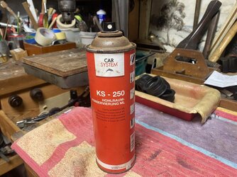

How about coating the horn internals with a conservating wax spray? Spray it over everything and clean it off the electrical contacts only. Should keep rust at bay forever. The stuff will eventually dry, not attracting dust ect. Not much heat develops when beeping the horn, so it shouldn't melt all that quickly either.
I use this stuff a lot when storing metal spare parts, saves me wrapping and bagging all the bits. Spares tend to lie around for a few years before they're re-visited... Washes off easily with the solvent in my parts washer, brake cleaner, turps, kero, petrol, what-have-you.

Yep, thats good gear Peit, use it to spray all the hard to get to places on the frame when they come back from painters/powdercoaters.
stops the insides of the frame tubes rusting .
