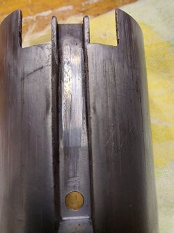

20221119_182451.jpgI bought these lightly used and (undisclosed till I had paid) slighlty incomplete carbs because my they were local and my bike ran rough. So much of the bike is original I feel these spoil it. How do I go about appraising the old ones and figuring out what, if anything, they need please?

Slides are fit for the bin.
Try a new slide at 1/4 lift in the old carb body. If the slide can be moved laterally in the carb, carb is dead unless you can find somebody to sleeve it. The female coupling original carbs may look better but a bike that runs rough and risks holing a piston is no good. If you go ahead with the old carb bodies, new old type slides are hard to source. New model slides need the idle ramp modifying.
Or fit Mikunis. :-)
I've modified dozens of these new slides to fit the old-type bodies, no issues whatsoever. Very little of the ramp is removed, enough left to last longer than the rest of the slide.

The dark grey colour and a few other details suggest to me that they might be modern replacement carbs (ie 'new type'). Might have 'old' slides in 'new' carbs?
Dellorto UK are extremely helpful, if you have a bit of a mixed bag and not sure, give them a call and/or email them some photos. They can identify the parts visually with much more certainty, and advise what you need to make them work together properly.
