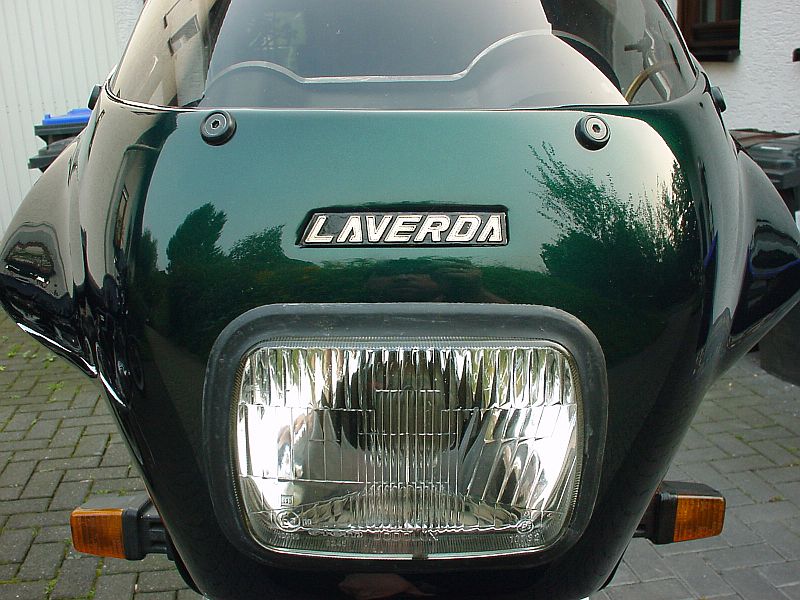

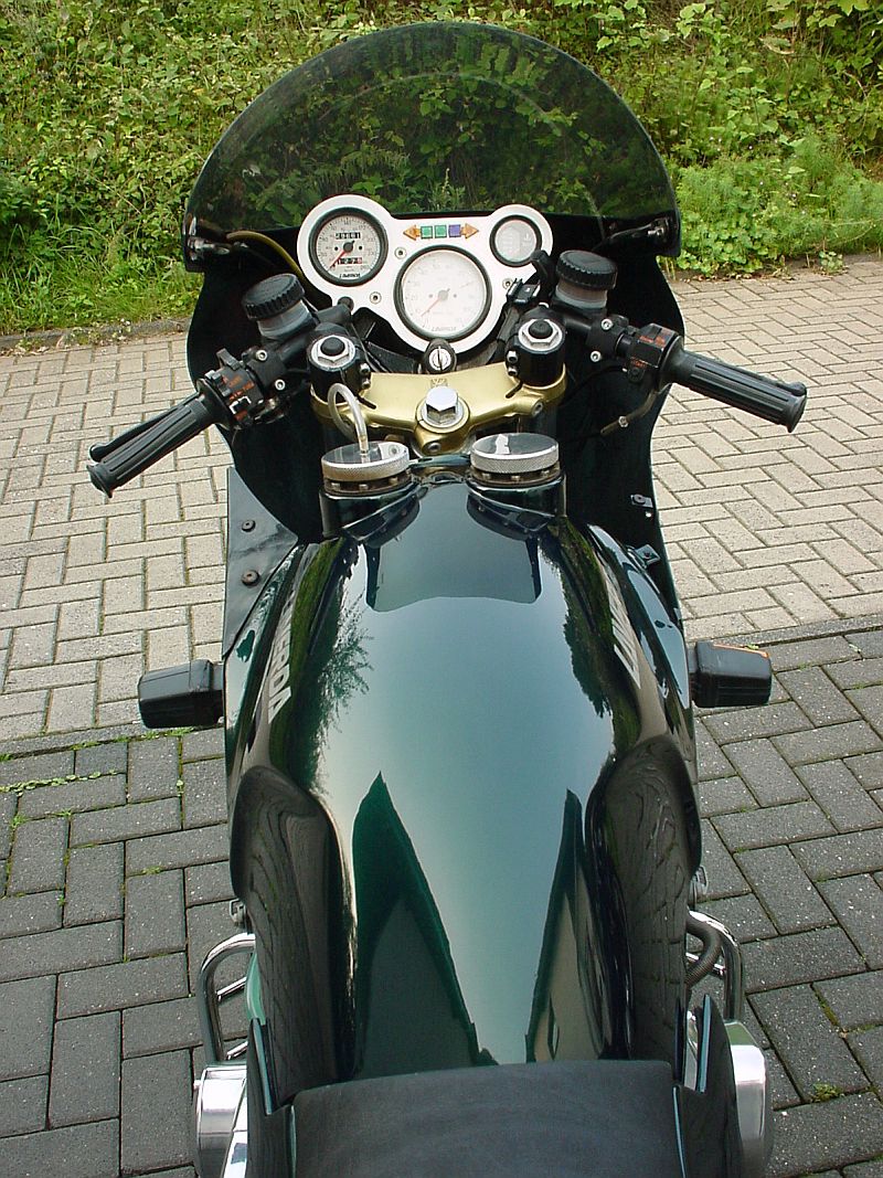

Part XI - The SFC Story...
As said, in late 1999/beginning of 2000 I had the chance to aquire a long term desired bike, an 1000SFC (or more correct so, a RGS 1000SFC). I liked the style of the bike over the RGS which I felt did not really look sportive. Allthough the SFC has the same weight I think, it looks way lighter and way more agil. And - it is the last modell of the 120? Series, just like my Jota (ND) is the last modell of the 180? Tripples (ignoring the 1200TS...).
As I was so used to change things on a bike only when I drop it, I finally did it also to the SFC...  ::)
Again on a lousy raining day, I was driving home from biker-meeting just around the corner. Tyres were not warm (and they were still Metzelers...  >:() and on the slippery roads after 4 weeks of no rain and rain now, the rearwheel tried to get in competition with the front one and - won...  :-[
The bike looked awfull, it was really like someone had cut my arms and legs off. I physically felt the pain it must have had and - believe it or not - I appologized to her for having droped her...  :-[
I had to leave her on the pavement when my wife picked me up (again...) so I could drive back with the trailer. When I returned to the bike, a little note was sticking to it. "I'll buy it if you want. Call xxxxx-xxxxx." First thing I wanted to do is to throw the note away, angry as I was. I would NEVER EVER sell it, I would built it up, no matter what it costs!
So I did.
However, I called the guy just to let him know how pissed I was about his note! It turned out to be that he was living not very far from me and was having a 1000SFC, too. He did not want to brake my bike, just thought also to build it up again so he has two. That said kept me from shouting at him and after a while I recognized, that we were chatting already for 2 hours on the phone. Unbelievable... months later, we met several times and had a good trip together to the Simbach-Meeting in 2003... ;-) But back to the SFC...
I allways thought that the red does not really work well with the gold. However, changing the Frame-color was no option for me, as it meant a total stripp of the bike, which I was not willing to do at that time. So - it had to be a different color for the fairing, tank and seat. ;). I allways loved dark green metallic and when I once came to my car-dealer, there was a Volkswagen Golf (Rabbit) Cabrio (Convertable) in classicgreen perleffect, which I took a note of the color code (LC6U) and gave it to my painter

That is a magnificent 1000SFC. May be the prettiest I've ever seen-just f*****g spectacular.
Thanks, I must say I am a little bit proud of it... I think the green (which is from a Volkswagen from mid 80's - so "contemporary" if you will) fits the bike very good and any time I go into the garage, it is not the first thing my eyes catch but it is the thing they last the longest on...
Imagine what the sales numbers would have been with this color sheme...  :-[
Laverda prefered the red, Uwe Witt (who bought and sold most of the 1000SFC and who was a major part of the design) was more for the "John Player Special"-Design, hence the black "classic" SFC's, which - I think - were all just repainted for Uwe.
It is somewhat funny that the company that had beginning of the 70's the largest number of available color's for the bikes had end of the 80's the lowest number: RGS just 2 (red and silver), SFC just 2 (red and - due to Uwe Witt - black). I think that was already a sign of the upcomming end, but that is the wrong thread for such thoughts...  ;)

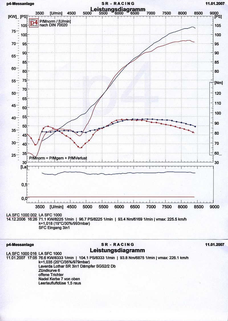

Part 12 - at SR-Racing
as said before, SR-Racing was recomendet to me for fixing the Exhaust issue. This time it was not just a the collector (but also...), it was also the can that was to small (allthough I found it to be looking quiet big...).
Sepp, the owner of SR-Racing, is what I would call a typical bavarian character: quiet self assure (almost to a point where you could feel he is arrogant, which he is not!), very streight, not communicating very much - unless you touch a point in his heart where the emotions start to boil (hopefully you touch the positive part, as otherwise he for sure would throw you out of the shop. Simply a character you either love or hate, which is based I felt on missing aknowledgement of his achievements in the press and customer base. You feel he had a hard time to build up the company and make his name and brand known against competitors like Acrapovic, Termignoni, Devil and the likes. I recognised that quiet early and gave him the chance to present his company and achievements to me, which was not only impressing and interesting but also built a basis for us two on which we could talk. Somehow we found a good base I felt and it seamed he liked me quiet much, so did I vice versa.
He told me about some projects he was working on, one was a BMW 1200 Motor in a cart (yes, really!!!) which he was working on for an arabic customer, one was the new F800 BMW which he had the prototype exhaust made for (all F800 sold after 2005 have an exhaust system that is based on his design!). The reason why BMW chose him was the fact that he had tested their K1200 (the 4 cylinder in-line motor bike) and found it to have 30 HP and roughly 10Nm less than the catalogue claimed and he had built a system for a customer that showed impressingly just 1 HP over the officel number (which is 31HP more than the original Exhaust let out...) and an impressive 25Nm than the factory claimed the motor should have. He published that result in a bike magazine and the day it was published, BMW called him and asked for an appointment...
"First I thought they would make their lawyers slice me in pieces, but then I realized: it was not the lawyer calling me, it was BMW R&D. So - I took that as a positiv sign and made the appointment."
The result of that meeting was the contract for the F800 he said. Big respect for BMW for recognizing their lack of knowledge there and outsourcing the development to a specialist! Not every company would have done that, many would just have bought one system, cut it open, examine it and would have tried to copy what they found...  :-\
Sepp and his wife, an attractive woman in her early 40's, are not only running the shop, they are both also participating in amateur racing and - may I say - with some success: he won the big bike class with his Kawa (I think it is a 900 or 1000ccm race bike), his wife was secound on her 600 Kawa, both in the same year: 2000...
But back to the Laverda..  ;)
I talked to Sepp about what I would expect and what I would like the exhaust to look like etc. and he agreed he will make it best possible, I should give him 2 weeks, which I did. I left the bike and trailer with him, reminding him several times that the clutch actuation system is very fragil and suffers from the dyno-testing where you pull the clutch lever at highest RPM to measure the loss of the gearbox and chain etc.. I requested him NOT to do that, I would be more than happy just with backwheel power. He agreed on that and off I went.
Just one week later, I got a call from him telling me that he is working on the bike and has reached already 100HP (95 was the max with the old system). He had removed the airbox, as it was taking away roughly 3HP and also some midrange torque (!!!!!!!) and is running the bike with open bellmouthes now. He needs some more fiddeling and will test some different cans but is quiet sure to reach a result above 100HP shortly. I was so happy, you could not tell!! At least until he called me to tell me he can not continue, as there is no clutch power anymore and the slave was pissing fluid out constantly.
"Sepp - did you pull clutch at high revs?"
"Sure - how else should I measure the real power of the bike?"
"Sepp - didn't I tell you NOT to do that?"
"Not sure - did you?"
"YES!!"
"What ever. Pick up the bike and fix it if you can, I can not work on a broken bike!"
"Well - I can come down to you and fix it at your place if you let me. How far are we away from the final result?"
"No problem, just come down and fix it. I was just about to test two other cans to see if they work better. BTW: midrange is way to rich! You need to set the carbs, too!"
"OK - I come down on Wednesday and will stay until Thursday. Do you think we get it completed so I can get back home on Friday or maybe Thursday night?"
"No problem."
So - I went down to SR-Racing with two new O-Rings in my pocket, a new slave piston, some new steel-balls for the piston and between the push rods etc. and fixed the bike early in the morning the next day. The piston was completely damaged and the rods were welded together. YERK!! However, after roughly 4 hours (had to take off the primary cover, as the left push-rod did not want to come out and had the steel-ball welded to it...), I got it fixed and we could re-assemble the bike and put it back onto the dyno. See the video:
SFC 1000 dyno run
Unfortunately, the clutch slave was damaged on the same run again, so I had to get some new pushrods the next day to fix the bike again, as we needed to drop the needles and make the next run.
The bike put out some impressive figures...: roughly 104 HP and 94Nm with a maximum of 8.500 revs, about 10% more than standard. Not to bad... We had one run where we reved it to 9.000 and it put out 110HP. Unfortunately I do not have a copy of that one, but here is the one we used for the T?V-registration of the exhaust...:
However, there was still a slight drop in torque in midrange which I know today is caused by a still to rich setting: the bike consumed 10 Liters/100Km where it should run with a maximum of 6,5 or so.
I am currently on the way of adjusting the carbs again with my Lambda-Tester on the road and found already that except the main jet (which I had taken down to 145, which is to low!), the complete bike runs to rich until 7.800 revs, then it directly goes into lean. Will fix this the next days hopefully and enjoy the run then - the sound is really tempting... (almost like a Porsche...) :-)
*Next: the Zan? virus striked me down...*

Lothar,
That just goes to show how good the corsa engine really was made.  8)
Hmm, something happened here. Suddenly I got a star more and came to ride a 250cc. So can I buy it now Lothar?  :D
While you think it over, I'll pop to bed and dream of all things Laverda...
Cheers,
Jacques  ;)
Hi Jacques,
yes, well spotted: the result has no Motor tuning in it yet, it is only the Keihins and the Exhaust. Imagine that...
But I promise, I will make the motor run even better when it is opened the first time. It makes some serious noise currently so I guess I will have to grap some money and turn up at someone close by to fix it...  :-\
