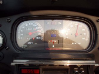

well, does anyone remember the photo I took and posted a few years back on MSN Laverda of my heavily "built" Harley full dresser Ultra Classic speedo slowing down to 160 kph, taken with both hands off the bars and the bike on cruise control.
this one (attached)?
