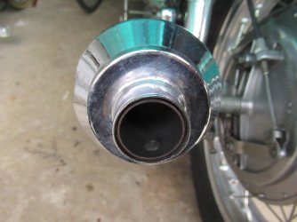

How to silence your Jota pipes? Why would you? Too loud when driving slowly in the city? Solid sound at higher revs is appreciated very much
Just look for a (near) perfect fitting pipe/tube and fix inside at the end of the Jota exhaust see picture.
I found these ones:
https://www.praxis.nl/badkamer-keuken-wonen/meubelen/meubelpoten/duraline-meubelpoot-rond-chroom-3x30cm/6536038
Tested with a dB app on my smartphone, pipe 25cm long. Also tested 30 cm, same results but engine becomes less crisp
at idle 1000 rpm -8 dB, that is 8 times less experience in sound!
at 2000 rpm -3 dB
at 4000 rpm almost no effect
Ciao
