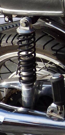

Can anyone identify these shocks for me. Can find no name or number on them. Off 77 Jota. Thanks Richard

Fontana (FAC) shocks. Sold by Phil Tod in the 90,s

Thanks for info, any idea who might have parts, scrolled the internet without much luck. both rods rusted at the top. Richard
Yes FAC's, bought mine off Phil Todd for my 81 Jota in about 1990, London.
Good shocks. They were the lightest of the 5 main springs available from FAC Italy,
I dont know if spring colour denoted spring strength, my springs are red colour.
The top seal is an odd one, The rubber seal is backed by a small conical, spring steel shape. Shaft is 11mm.
Local bearing expert has never seen them.
Closest replacement is a lip seal 7/16 (11.12mm), but does sweat a little on shaft in hot weather.
WIll machine up new threaded holders to fit modern M11 double lip seals. Should solve problem.
Anyone ever seen an FAC parts diagram/listing or any other data info. like oil weight etc. I'm using 15W fork oil.
I never opened mine, but you can have the rods hard chromed to give them a new life. Done that with several shocks. It’s not cheap though, cost me almost the same as re-chroming a pair of fork stanchions, but I think the FACs are good enough to justify it.

yep, very surprised at the cost of getting the rods re-chromed and who’d have thought, one off special seal no longer available. Old bikes eh …..
