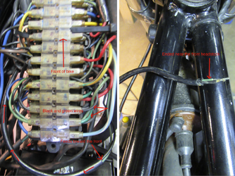

Identify these 2 green/black wires please
TeddyG
Portland Oregon
I'm going to attach the loose zip-tied cover better and somehow brace the whole loom so it's more secure, but wondering what these 2 green/black wires should attach to, as I see no loose connector near the horn area. I'm guessing they are turn signal leads (it doesn't have signals). I looked at the Green Book schematics but unable to decipher it. Thanks again!
Sorry- it's a 750 SF.
Thanks Piet- I did wonder if it was the horns but hard to see it tucked away so I'll remove the horns and look for the connector. Since I've found the battery cables were corroded and replaced them, I'll check all the other wires for continuity. I received the bike beginning of Dec and was only able to start it briefly (erratic idle), and now going thru it and checking everything and correcting whatever I find.
