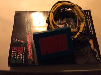

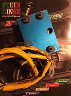

Hi Niels.
Here are some picture :
Price: 250 Euro.
Br
Peder

€250 😯. Won’t chuck out that blue one I have tucked away then.
I had a similar reaction. That seems (in my opinion) a crazy price for an old blue box. It's almost twice the price of a brand new Ignitech box (€135 without VAT) that'll work with the existing pickups and do a much better job.
The "blue box" Moto Witt DMC 1 is a very old unit. It was superseded by the brown (gold?) box DMC 2 maybe 15 or 20 years ago, which has since been superseded by the DMC/32. A new DMC/32 for a 120° Laverda, complete with wiring harness, pulse rotor and pickup plate is around €400.
Buying any used ignition unit is a gamble, especially one that could be 30+ years old.
I had one of those blue boxes (for a 180° engine) on my Jota and I found it to be quite unreliable and very fussy about system voltage (needed its own little supply voltage regulator). I replaced it with an Ignitech. I don't remember what I did with the old DMC blue box. In my estimation it was worth nothing, so I probably chucked it in the rubbish bin.
Apologies Peder. I don't usually comment on the prices people ask for things. But in this case I think you may have misjudged the market.
Closer to 25 years, Cam. :rolleyes:
When I left Moto Witt in early 1998, production of the DMC II was already ramping up, mainly due to many parts for the DMC I having become obsolete and to incorporate external programming feature and the removable pig-tail. Matter of fact, good chances that I actually assembled that blue DMC I!
DMC I enjoyed a production run from ca. 1984 to 1997.
