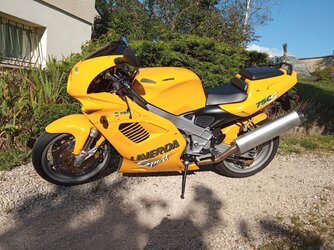

Hie every body,
wou'd you like to try this one, it's for sale in France.
Very good condition , just 3900 kms in 20 years.
