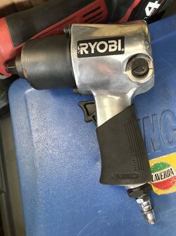

A couple of years ago I bought an AOK pneumatic rattle gun, made in Taiwan, but says designed in Oz on the label. Plenty strong enough to loosen the Jesus nut, even manages to un-do drive shaft nuts on the Skoda (tightened to 200+ Nm!) at 6.5 bar air line pressure. Reckon it'll manage a little more if I up the pressure a bit. Anyway, well pleased with the gun, and very affordable. https://www.ebay.com.au/itm/263929676355

1/2” drive

Grazie tanto, Pat. I'll see if the budget stretches to the one that Piet recommended. Might make sense to have one in the armoury. if I get stuck, it's nice to know I can call on you ... once they increase our radium limits from 10k!
