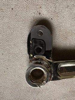

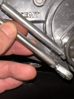

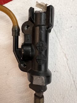

I sent the one off the Corsa to Paddy he identified it as: replacement oem Yamaha 4GVF583V0000 (link below) I took some photos as stripped the bike attached are a couple. The brake lever is extended 18mm centre to centre and the linkage is 5 mm shorter. The Corsa is still in dry dock so not used the improved set up but Clem rates it so it must be better than standard RGS set up. :)

Thanks, Dexter. This is the setup for the RGS, which is a push-operation. The 1000 SFC has a pull-operation. Not interchangeable unfortunately…
