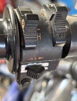

The plastic end bit of my indicator switch has disintegrated, see attached. I believe it’s a Suzuki switch but looks pretty much the same as NDenso on my GTL. Does anyone know where/if I can find the end bit? I’ve looked at a few Suzuki switches from the era, but not found one that has the bit held on by the tiny screw. Thanks
I also need the turn signal piece and fashioned a temporary one from plastic scrap and a cotter pin. I thought these ND pods were Honda but apparently they are Suzuki-

Indicator knob, as others have pointed out. Laverda used the earlier version, your pic shows the later type as used by Suzuki (exclusively?).
It's not quite as nice as the original, but does the job. One of these days I may get around to tweaking the design and round the edges a bit, the resin print should turn out quite OK.

see this thread.
The 3d print files are shared in this site, I made some and am very happy with the results, really can't tell they are not originals.
There are designs kindly shared in Resources here by our friend Sami in Finland "cape" for the three knobs on the left ND switch.
Not commercially, at cost, happy to make some more if there's demand on my visits to the shared 3D printer facility, they weigh next to nothing so postage shouldn't be too much shipped to to you from USA (to date no tariffs outbound).
