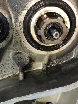

Unfortunately, after close inspection, following several minutes of stationary running of the engine of the 840, it was clear that the issue was not blocked breathers or leaky oil seals but a leak from the crankcase joint to the rear of the lay shaft seal, which when it had spayed around a bit had given the impression it was a seal issue. Even a retightening of the crankcase bolts didn't have any noticeable reduction in oil flow, so a decision was reluctantly made to park the bike and concentrate on the 650 for the junior super bike race. ☹️

Bummer about the weather, Andy. Not much you can do on road tyres up against riders on full wets. I had a leak from that general area and tried a couple of different things before closer inspection indicated it was oil escaping from between the 5th gear output shaft and bearing/spacer (pic). I cleaned and dried the interface behind the sprocket and filled it with silicone.

I did momentarily consider trying to do a temporary sealing job, but the thought of it failing and getting oil on the back tyre on wet roads on a street circuit just wasn’t a sensible idea.
if it realy is the crankcase joint, then loosen the bolts, liberally rub a bar of soap, Lifeboy is good, but Imperial Leather, of Dove works just as well, into the joint and retighten, you will be surprised, Tom did this on a Cagiva Navigator, (suzuki V twin engine) that got accidentally bumped on a hidden curb in long grass of a foreign petrol station (he was short cutting) and was told this trick by a local old lag, farmer type, and it worked, never did do any more and two years later prior to sale it was still sound, and smelled lovely!
I am serious Andy this worked!
I've done the same to fix a leaking fuel tank.
Soap rubbed into leaking fuel tank hole (this case was rust) then tap over with 'Gaffer' tape to protect soap.
Soap goes gooey and then hardens.
In the Outback of Oz you do what you can.
Okay thanks Clem, I will discuss with my Viking mechanic friends who are about to set to and remove the engine.
