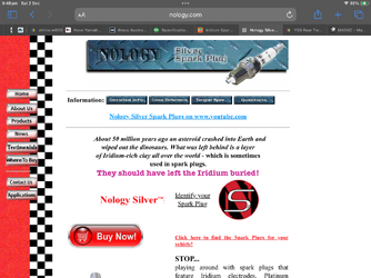

Reckon that they should have left that Dam iridium buried but then again what would I know right
I mean everyone who has even a minute level of intelligence would understand.. god dam it so why reinvent the wheel… just quietly Tom’s mate tried it and they failed miserably.

Nology L4YS or L0S for the SFC1000
