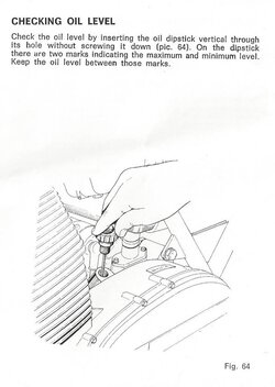

Many thanks for all your help. Connected up the battery, put some fuel in the tank and checked the oil level. Started in 30 seconds after sitting in garage for 20 years. Which leads to my next question, do anyone know the standard quantity of oil required for a change?
For an empty sump, including the oil filter, it's approx. 3 litres.
I usually add 2.5 litres and go from there, adding small quantities as necessary.
FYI, the oil level is checked by allowing the dipstick to 'hang loose' vertically - do not screw it in to check the level! (and apologies if I'm stating the obvious) :)
No you are stating the obvious as I was wondering myself about the dipstick. Many thanks for you help. Going to put new plugs in, change the oil, free up the brakes and take it for a spin. Fingers crossed :)
