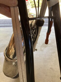

is this normal ?
1200 JOTA
Australia
motor out for a head gasket and valve / cam clearance adjustments, clean the frame before re-install and then this ....
this is a triple and all other frame 'measurements / alignments' look normal and straight, the welds are OK, no cracks3A2062DF-CDC4-4242-AE8E-A9D442DD5CB8.jpeg
You wouldn't be the first to have it "repaired".:oops:
Check where the down tubes mate to the headstock, totally wonky!
I wonder what the header would look like if the frame tube was straight? Probably a very difficult combo of bends would be required. I spose we could ask those who've 'repaired' the bent down tube :ROFLMAO:
so the answer is "yes, it's normal" then ?
phew ... 'cos it feels fine on the road and everything fits
Yes, is normal

It was either that or scallop the header, or no l/h header at all. Or do what H/D did with their rear pot ..... fuck up everything.

the factory prototype triple had a cut and shut in the left pipe, to kick it out of the way of a straight down tube. You have to guess here but I would say that someone decided it was cheaper (but by how much?) to have Verlichi (frame subcontractor) put the kink in the frame rather than the a cut and shut in the left pipe.
that "defect" carried over to the totally different framed RGS type, how could that happen?
