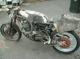

I bought this pile of junk circa 2008 from a guy in the Wirrel in Lancashire, when I stripped it I discovered that the frame was a lash up
and the engine was built repaired scrap parts, crankcases were junk, crank was junk, head was warped. I stripped and kept any viable parts and I sold the frame to a guy in Elgin , north of Aberdeen and he couldn't do any thing with it either.

When you say “lash up” bad welds/ not straight?

So what parts did you keep Glenn as from the photos of the cremated bike it looks fairly complete?
I can add that at the Manx in ‘84 the crankcases split, I think it was on the alternator side, and I had them welded by Steve Overton. AFAIK quite a few of the bored out Monty’s of that period suffered a cracking issue. Can’t comment on the head, although again it’s not uncommon for a 500 head to warp if the head gasket blows.
it looks to me like the frame and swinging arm was heavily modified by someone after the fire.

I kept the crank, the cases even although they buckled probably during the repair process, the front and rear wheels, the head and barrels, gearbox
I no longer remember all the issues with the frame other than it was not thought out and that it appeared to be almost impossible to get the engine out without damaging the frame paintwork

Did you bought the burned bike in 2008?
Like Andy J said, big bore monty's are build to braek down. And I have seen a lot of poor work on Laverda's. That doesn't mean that all is bad done.
I also strugle with the engine and the frame. I want to improve that. Andy said he has done a bit also. I was worse than it is now.
What parts do you still have? Maybe you want to get rid of it?
I realize it's an difficult bike but I like to rebuild it.
Do you know names off the guy's you bought and sell it to/from?

Those crankcases split, alternator side, even on standard 500 when raced. They do not need overboring.
My TT2 engine prepared by Cavazzin has preventive welds around the right hand crank bearing and apparently, according to van Dijk, inside the crankcase.
Maurice Ogier had a set of cases cast but needing machining to try and get around the problem. He told me about those when I enquired in view of buying his bikes.

Andy,
I don't think there are much changes between the burned bike and my frame. What changes do you see on te photo's.
There are a lot of changes between the ladypictures and the competitionbike. I can see there is welding done for that.
Can someone tell me:
On the pictures off the burned bike there is no mount at the front off the engine. I think there was a subframe/loose part.
Was it there? Does anyone know howe that looks like? Who forgot to delver it with the bike?
