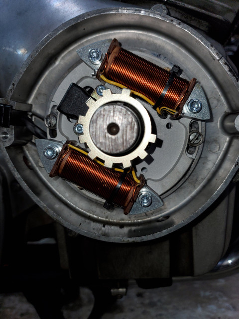

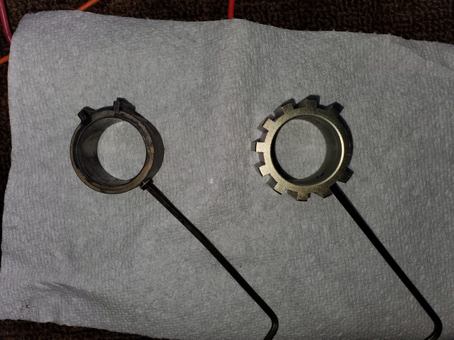

Got mine from Wolfgang in September. Very painless change from the old DMC. The position of the reluctor in the documentation was unclear as it can be installed 180* flipped. I took a picture as it worked for me:

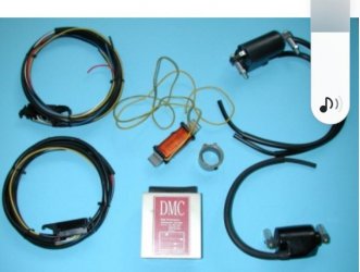

So the Whit kit I asked about is the old one coil model ... perfect would have been an easy mistake.

Just to be clear - the 'one coil' shown is a replacement charging coil. It's used instead of the 'magneto' coil which powers the original HKZ black box to fire the plugs.  The kit pictured retains the original Bosch pickups which will by now usually suffer from deteriorated wiring.
