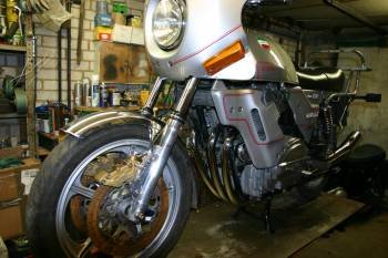

go down this route, 916 master cylinder generic (eg) 916/Zane callipers, very rare 27mm offset 320mm rotors (no speedo problems) and Reds callipers, but fitted to the front and shimmed correctly. You can use generic 320 rotors with 7mm offset and different bolt PCD, but (again) red makes adapter rings, but can (not always) cause speedo drive gearbox problems, in my set up that didn't happen so I don't know about it, should you want correct offset rotors mine came from  Cagiva 500 GP bike. I believe some Ducati race bikes also used them (Paddy?)
take note of Robs comments on pads and s/s rotors. makes a huge difference
