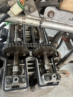

Back then I got good advice to remove cam covers and crank to check for oil getting up to cams before starting.
I have removed cam cover today, still oil in the head. Spark Plugs are out, i put a little engine oil down each cyl bore, turned the engine over by rear wheel, all good, clutch also is free.

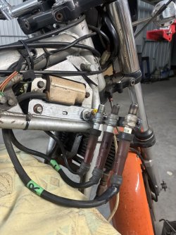

Three old spark plugs mounted and bolted to frame, also an earth wire back to starter motor bolt ( i am paranoid about frying the ignition )

Plan is to Crank over till oil is seen at cams, then replace cover.

Your bike has a Bosch BTZ ignition system. I don't think they're as fragile as the earlier HKZ type on pre 1975(ish) Laverdas, which would fry its brain if cranked with plug leads disconnected. But I wouldn't risk cranking it with the plugs disconnected anyway, just in case it might fry an ignition module.
You have several options for cranking on the starter motor without plugs:
1. earth the plugs elsewhere on the motor to complete the spark circuit.
2. un-plug the two Bosch ignition modules before cranking.
3. Crank the starter motor directly using jumper leads and a remote battery. Positive lead on the starter motor positive terminal (on top of the starter motor). Negative lead somewhere on the motor. This won't power up the ignition modules.
Seeing as your bike doesn't actually have a battery in it at present, option 3 is probably the most convenient.

The oil pump is unlikely to have failed from sitting. So looking to see if oil gets up to the cams is a waste of time.
Drain the old oil and replace with new, start it up and go ride it.
And yes the factory ignition is crap!
I think he wants fresh oil on cam bearings etc. Only a few seconds "wasted".
The point of removing cam cover was to make sure i had oil up there prior to starting, ( not to check oil pump ) did not want to start with dry cam lobes etc, also i wanted to check the cam numbers. Cam cover also needs a good clean !
If you're that concerned about the cam lobes you could alway put a LIGHT coat of assembly lube on them while you have the cam cover off. That should buy you enough time until the pump gets the oil to the head. It certainly won't harm anything.
It might be good to remove and inspect the oil filter screen, even though the old oil is clean and assembly lube on the cams is a good idea from Ian. Best of luck getting it running again!
Thank you both Teddy and Ian, Good advice, i dropped the exhaust pipes off yesterday and drained oil out, washed the screen out , looked good but now i know its clean.
Good idea on the assembly lube, will get some and do that before cranking, made up some new oil cooler hoses today they were looking a bit tired and hard, so thats really the Lube system checked externaly.
