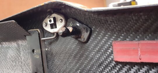

This is what I did. Cut the spiggot from an old seat base
Weld a plate on the base and drilled and tapped. Also the seat latch I made with ally plate

OK, it's simpler than I thought. I haven't actually looked at mine. I thought it had a notch all round like a hose barb.
Just get a bit of round bar or a bolt shank, cut a notch in it and weld it to a bit of plate.
