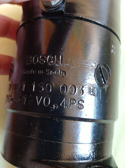

For sale is a starter for a jota 120°. Starter is freshly refurbished by Peter Piffka. Part No: 0 001 160 003
Everything tested and ok! Runs like new. Part is in Germany.
Price 475 Euro + Shipping costs
Thank you!
Harald

Lovely job, Peter is a friend of mine and does a brilliant job on reworking those starters. He even upgraded mine roughly 15 years ago to more windings and therewith a bit more power, water-sealed it and added new contacts etc. Runs sweet and reliable still today in my 180° Jota (ND)!
realy?
I know that you have to use a different gear to use the SJCE in an old Bosch engine.
Also the orig. gear from the Bosch dont fit the freewheel in a 120° engine?
Am i wrong?
Volki
there are transition-models. my 180° ND engine has the Bosch-Starter, though it shares the general setup with the 120° Jota models. Not sure if SJCE maybe started with the RGx-Series maybe??
Piet will know for sure... ;)
My Jota 120 has an old Bosch 180 starter motor fitted it works a treat. The number of teeth on the pinion is the same as an SJCE starter. As I said before the starters are completely interchangeable. You can of course fit an SJCE starter to any 180 engine.
Alan.
Yes - the only thing that does not work is using the starter gear of the Bosch starter on the SJCE or vize versa. The gear itself is different, hast the same number of tooth though. See:
