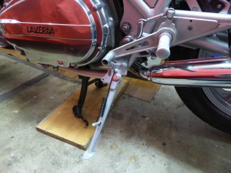

My set up for reference.
As you will read up,there can be a conflict with some centre stand tangs,but I was very lucky with mine.:cool:
