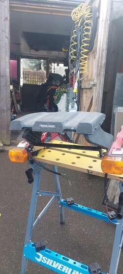

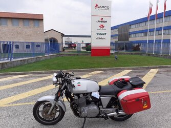

Sadly Maurice, Breganze is not achievable this year, 2019 was a hoot tho, it was great to meet you & Team BFN on the ferry & ride some of the way to Jaca, a trip to remember. Dug out the krauser rack. I only used it for that trip.
