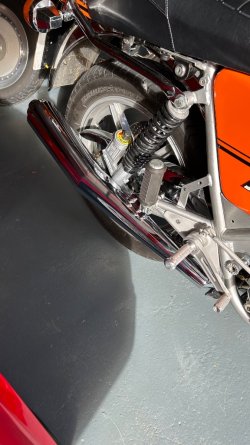

I’ve very recently replaced a pair of stainless silencers on my Jota with a pair from Malcolm and they look, sound and go much better. 😈
