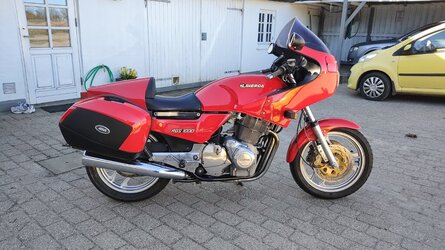

I have just attached a pair of Givi panniers on my RGS. Modified the original brackets to fit the RGS Regards.
Preben

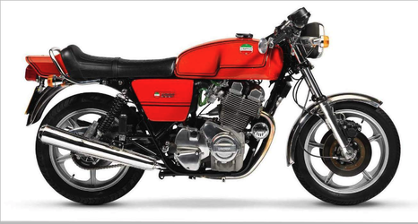

Hi Miguel, I think the 3CL used - at least from 1980 on - the 1200 Frame. easiest to spot is the angle of the rear suspension. 1st pic is a 3CL with relatively upright rear suspension, 2nd with the forward position of the rear suspension. That should indicate the 1200 frame.
Hope this helps. The point why this is important is that the luggage rack might mount (as on the RGS/SFC) to the upper suspension mount if I am not totally wrong. I know that someone on here from the german forum members has lent his bike to H&B to get the rack made up. And yes, it's produced on request, which normally takes about 3-4 weeks. Might have been quicker end of season, but who knows. HTH
