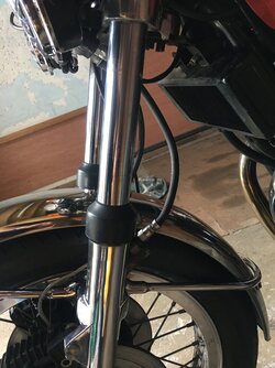

Thanks for the info on the foam filters. Never considered that alternative. Guess that is why I asked. I am hoping someone will help me with another issue I am attempting to resolve. The front brake lines on my 1974 1000 3C were replaced by the previous owner and appear to be new stainless steel braided lines. They are obviously routed incorrectly and look terrible. Would someone please send me a link or post a couple of photos of the correct placement of the lines. Thank you very much. John
