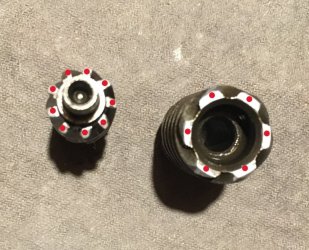

Hi, if you look at both gears end on as per the photo, then the tooth count is 9 & 6 for Alpino & Monty.
Tooth count for F500 is 10 & 5.
That would make the original Formula 500 Competizione tach 4:1! I recall them having 5:1, mainly on bevel Ducatis.
Yes, 4:1 is correct. I have both the 3:1 & 4:1 sets of gears here in front of me !
