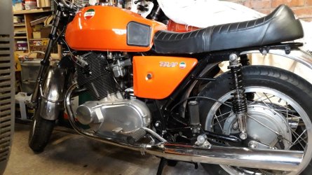

Hi all, is there a change over point for the side covers on the K0, I've seen some without badges and other with badges at the front and others with badgers at the rear of the side cover. Mine have badges but also extra holes that appear to have been filled at some point with body filler.
I'm trying to return this bike to some sort of originality.

Hi OTR002, there is no 750SF K0. Do you mix up Laverda and Hondas? You mean the early version of the 750SF called sometimes SF0? The frame number or some pix would help to lead you in the right direction. Ciao, Gert
Hi rez, this 750SF is not in original condition. Todays adverts are never a good source for infos about originality. You should look for original pix from the period, brochures, manuals and some LAVERDA books. Ciao, Gert
Why isn't this bike original? what's wrong with it? I'm still learning to speak Laverda and any guidance would be grand.
Cheers
Hi, correct down pipes but wrong (later) silencers, seat should have the old version of the LAVERDA lettering, wrong painted tank emblems, side panel emblems are located very strange - so I think there weren't any emblems, silver painted rear light shell instead of black, wrong foot rest rubber on the left side. Maybe someone will find more ... But everything easy to get it right. Ciao, Gert
Imho, the reason for the side panel badges on the 750 models is that with the launch of the 3 cylinder models, all Laverda twins then onwards shared the same tank badges with the triples which no longer said 750 and the "750" (and "1000") moved to the side panel badges. So bikes before the launch of the 3C generally had "750" on the tank badge and had no side panel badges.
