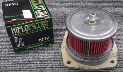

Better OEM oil filter (wire metal mesh) or Hiflo 561 in your opinion for Laverda 750 SF1 engine ?

Wire mesh better IMHO. The oil system is a low pressure / High(ish) volume design and any restrictions may cause the pump 'gears' to move oil very inefficiently.
As the "filter" is on the vacuum side of the pump, any additional obstruction can cause havok. I've seen quite a few destroyed engines where the stock mesh had been clooged, a finer mesh clogs easier...
If a filter is to be added, I'd put it on the pressure side of the pump.
very strongly agree with Piet.
once the oil has drained to the sump, by gravity from all points of the motor, it has to "flood" into the inside of the (stock) mesh filter, from the height or depth of the sump capacity, although inside the filter will be under (a little) suction from the pump, I doubt that a paper filter will allow enough oil into the chamber fast enough, then the pump will not have a puddle to suck from = DISASTER, the oil pumps on stock SOHC 750's are already known to only provide marginal lubrication, if the bike is at idle for any lengthy period of time, what you are proposing will make this a lot worse, my own (at the time) 2 year old 750 suffered "squared off" cam lobes at 23,000 miles due to a lot of city riding.
Again, as piet, install the filter (if you must, there is no need) on the postive side of the pump, this is a stripped motor/ empty crankcase job, involving drilling tapping, plugging, machining, and even (depending) alloy welding. Not a task an average DIY'er would be able to do successfully, it is possible though and has been done.
paper filter in sump? .....Dont do it!
if worried, strip the motor, clean everything, including internal oilways and the crank slingers, measure, new piston rings, grind valves, valve springs, seals, gaskets, rebuild, and you will get 100,000+ kilometres from then, even if the original stuff (pistons, crank, bearings) OIL PUMP!!! is within wear tolerances.
Hi Lavermax - It is very important to remember our primitive Lav oil pumps are not positive displacement pumps (especially as thy wear). They do not 'pick-up' a some oil and absolutely move it to another place. These gear pumps certainly 'encourage' the oil to move, by creating pressure differential between inlet to outlet, but if we include manufacturing tolerances and the 40 years worth of wear, they can become very inefficient indeed. The wear is not just the obvious radial things (pivot axis and gear teeth) but also lateral - between the end flat faces of the gears and case/housing. If the pump is very badly worn, then the gears can spin in the oil puddle and hardly move much oil at all.
