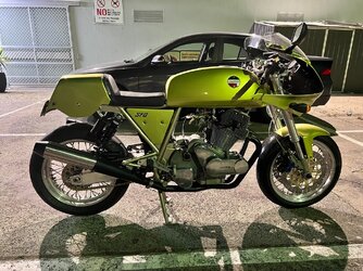

My pleasure. I would like to have some too. They look good don't they. Moto Officina gave me a quote of between 2,700 and 3,000 euros including VAT for supplying two brand new bespoke wire wheels. That's a lot of bread.
Yeah way too much. I have a Ducati Sport Classic and I just think spoked wheels look way better on these type of bikes. Even if they’re heavier.
Quite a few ways to rig up a wire rear disc for Laverdas. I've built one with a Kawa Z1000 rear hub, one with a Triumph Legend rear hub (was complete, but I disassembled and modified both cush and disc sides) and I have a Kawa KLR650 hub that I was going to use - a chap here in Melbourne on the Forum did complete the job with one very succesfully. Moto Officina on another planet with their prices, regardless of how bling they look - sorry.

The SFC1000 Classic rear wheel is not plug-n-play. The original caliper bracket will not fit, something else needs to be fabricated. The original conversion kits as supplied by Moto Witt included a bespoke bracket with an opposite sided caliper that fitted beneath the swingarm but utilised the original locating point.
FWIW, the front hub from SFC1000 also will not fit a 38mm Ceriani or Marzocchi fork, disc spacing is different.
By the time you've built a wheel and shipped it to the UK just getting money for your parts and time, you'll be on another planet as well.
