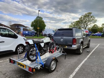

Having "won" the bike I borrowed a mate's bike trailer and did the 600+ mile round trip to Pembrokeshire collect it.
It was a long day, but the next day when I had a good look over the bike I was pleased with the purchase, it was all there apart from the fuel tap!

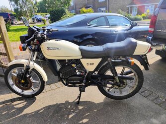

I got the NOS tank from Paul Marx and took it to my local paint supplier, they used a fancy camera to match the paint colour, it turned out the best match was a Mercedes colour, they mixed a solvent based paint and put it in rattle-can. Scrubbed all bits up with a scotch pad and warmed them up on the BBQ (Alan Milliard trick) and sprayed them, the results are pretty good.IMG20230529165745-EDIT.jpg

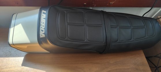

Next job get the seat sorted, does anyone know if it looks like a seat off any other model of Laverda or is it a peculiar one made for the LZ125?
I was at a bike meet last week and bumped into an old mate of mine who was on a 1986 Honda CG125. The seat cover looked very similar to the LZ125 one, so I bought one off eBay for £40 delivered.IMG20240730111422.jpg

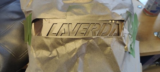

The base and foam was in okay condition, a few small cracks in the base that I welded up with my TIG welder. Painted the base and fitted the cover. I'm please how it turned out. Just need to design a stencil for the gold lettering on the rear part, then use my 3D printer to make the stencil.
