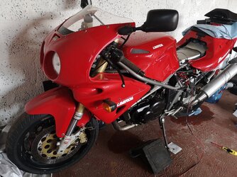

Hi, I have just joined this forum as I have just purchased my first Laverda. Its a 1998 Diamanté. I have never worked on these bikes and know nothing about them so I would really appreciate a few pointers as I know precious little about them. I am told the engine engine was rebuilt approx 10 years ago but I have no receipts to prove this. The bike was running when it was parked up about 6 years ago. I plan to drain and clean the tank and carbs etc and drain and refresh all the other bodily fluids and filters. Is there anything else I should check or do before I key up the starter on it? Many thanks in anticipation.

The bike does not have carbs, it is fuel injected. Therefore, after 6 years of standstill, all the associated bits and pieces involved can be dodgy. The fuel pump inside the tank is often siezed, fuel lines hardened and brittle.
"Engine rebuild" means nothing if you don't know what exactly has been done and by whom, they have several weaknesses, all of which are quite expensive to remedy. The charging and starter circuits are notorious for their inadequacies. Many threads about the Zane models to be found here, spend a couple of days with the search button. ;)
Hi Bill, welcome to the forum and congratulations on your purchase. Looks realy nice!
Piet is right with everything he said above (he works on Laverdas professionally), these bikes have known issues that need fixing sooner rather than later. How many kilometers or miles does the speedo show as total, please?

Hope you can fix it! Make sure you remove all fuel and fill in fresh one before you start the bike. The old fuel will prevent it from starting and you only overheat the starting circuit while trying...
Any history of what really was already done on the bike, please? That would be a good starting point...

another one to get back on the road - well done - yes they have some issues but they are great bikes to ride - fuel system needs to be clean , battery needs to be a good one , clean up every electrical connection particularly the starter circuit from the battery - join in on the Zanelist group

There are 14600 km on it. I've made a few inquiries regarding who even did the engine, but so far I've been hitting a brick wall. I will be starting with changing the oil and fuel and see where we go from there. Thanks again.

Paul is somewhat right. Most of the 750 engines develop a serious issue between 12.000 and 30.000 km - depending maybe a bit how they get abused... (warming up properly, using the right oil with the right changing intervals etc.).
As you do not know what has really been done with your bike's engine, I would try to find out and - if you want to keep it - consider a work-over before it blows up. That's definitely cheaper than fixing it afterwards... and it bears the chance to upgrade it to Formula 2000 specs if you like, which gives some extra ponies and torque... (different pistons, different cams, different chip)
